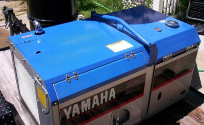

Hi All:

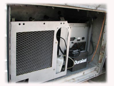

I've successfully transplanted a contractor-unit diesel genny (6.5kW, liquid-cooled, belt-drive alt.) into the old A/C condensor bay of my bus. It's plumbed into the main fuel tank and I added a little 4psi fuel pump. It's freakishly loud in operation, even though I added a beefy spark-arresting muffler, but I've got some ideas on how to quieten her. 3000rpm just makes a lot of noise... esp. without the hundred pounds of sheet metal enclosure I had to hack away to shoehorn it in there. At any rate, the issue de jour is how to add a remote start funtion to the unit. And Yamaha, the manuf. wants $450 for the unit! No way, I say. I'm thinking that I can accomplish the functions (GLOW/ OFF/ ON/ START) with some relays. Trouble is, I don't know how to design this system. I can wire and solder fairly well, but the concepts of relays tend to escape me. I have the old Onan remote start button and hour meter that could be pressed into service hopefully. The glow funtion could be accomplished with a momentary switch, maybe. I also bought a generic keyed starter switch. Below is a scan of the schematic I've been working with to re-wire the genny. Thanks for any insight! bb

I would suggest that before you do too much more, you run it for a few hours under full load. It may get too hot in the confined space, and the removal of sheet metal may have even compounded the problem. These industrial units are designed to operate in free space and they require a lot of air to cool them properly. As soon as you start adding noise reduction material, it may compound the heating problem. Much better to find out now, rather than after you have done a lot of additional work. Richard |

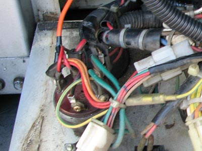

What kind of voltage and amperage is seen across those terminals? That will dicate what kind of relays and wiring will be required to operate that. Actually making it work shouldn't be too hard using a rotary switch combined with relays... Heck, that little thing is pretty easy. What gauge wires are currently at those posts? -Mac |

Mac: Most of the wires look to be #14. One on post #30 is a bigger one... maybe #12 or even #10. If I can just extend the wires about five feet, that could work, but I'm worried about too much voltage drop. Being able to start it from both places would be nice, also.
DML: The unit presently has gobs of free air circulation. Perhaps too much, because I have to load it up to get it to warm up and stop smoking. It didn't do that before I hacked it up. The enclosure before was amazingly confined with just a few screens along the bottom.

BB: I built the remote for my 7kw Isuzu from 3 20 amp capacity DC switches. a single spst rocker wired from the 12v power to the on position of the keyed switch, a momentary for the glow function and another for the start function, essentially paralleled the switch that came with the unit. Power for the Preheat and start is jumped from the 12v source coming to the remote switchs. No relays, #12 wire about 20 feet. 1st switch for preheat came apart the 2nd time I used it, replaced, and no trouble in more than a year. I built a 2nd remote unit for the dash but have not wired it yet. I put a terminal strip in the cargo bay inside the enclosure for the remote unit that came with the genset and added an hour meter for it. Wire any number of remotes from the terminal strip. |

We used a auxilary solenoid and are only using a switch up front to trigger the solenoid. Also have a timer circuit to run the glow plugs and electric fuel pump before the starter engages. This seems to work really well the dozen times we've started it. |

Brian, your amp loads for starting are not heavy enough to require any relays or solenoids. Voltage drop is not a factor 'til you get into long wire runs in the neighborhood of 75 feet or so. Use two switches (DC rated natuarally) #1) SPST (single pole single throw) #2) SPDT/CO (single pole double throw spring loaded to center off. Switch #1 is the on/off for your fuel solenoid. This starts and stops the motor by controlling fuel flow. Run a fused 12V positive line to the top of the switch, and the wire from the bottom of the switch goes to the fuel cut-off solenoid. Switch #2 is a momentaty contact/center off. The down position is for the glow-plug pre-heat. The up position is for the starter solenoid (aka Bendix) There are three wires on this type switch: the center lug is fed with a fused 12V positive. The wire from the upper lug will go to the glow plug, and the wire from the bottom lug will go to the solenoid on your starter. (i.e. hold "down" for 20 seconds for pre-heat, then a brief push "up" 'til it starts. Use #14 AWG THHN wire and fuse it at 15 amps on each switch. Remember that SPDT/CO switches wire up backwards from the way you think they would. i.e. when the switch is pushed "up" the wire lug used is the the one that is "down". Don't try to feed both switches with one wire, since the loads are too high. Uncertain? Email me off the 'Board. Good Luck on the trip. ...JJ |

Richard, that small genset starter solenoid pulls about 40 amps when first engaged, and the possibility of an AC rated switch arcing and welding together is quite likely, hence my recommendation for the DC rated ones. If this occured on the fuel solenoid (mine pulls about 12 amps) he would not be able to conveniently and safely shut the genset off. Am extra $1.50 per switch is pretty cheap insurance. ...JJ |

Brian's photos show a multi-position switch and then heavy wiring fed from that switch. Nothing was said of "control voltage," only 12V DC line voltage. Ergo, I concluded that is what he meant, and based my recommendations upon the premise of switching the loads directly, merely supplanting a $450.00 mulit-position switch with a simpler, much more economical solution to his dilema. The above notwithstanding, I still contend that you should not use an AC rated switch on a DC circuit. The distinct possibility of failure and fire are too great. If there wasn't a pressing need, we would only have AC switches, since they are so much cheaper to manufacture. My recommendations stand as originally presented. Brian, if you wish to use the key switch, use it in place of the SPST switch #1. A good choice, especially if you have rug rats, or rambunctious canine traveling companions. There are many configurations available for this situation, and due to space limitations on my panel, I have given you the one I chose, and I don't claim it to be the only or best one available for your application. Cheers...JJ |
