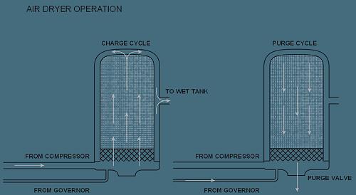

Air Dryer Most air brake systems today have an air dryer that traps water, oil and dirt in the air before it goes from the compressor and into the wet tank.
CAUTION Compressed air used in an air brake system is released from many of the system's parts. This air travels at high speeds and often contains moisture, oil, dirt, etc. which could harm eyes or ears. Know where air exhausts and avoid being in its path. In addition to chocking & blocking as has been suggested, don't forget to wear safety glasses and hearing protection. exerpted from the OSL Air Brake Endorsement Instructor's Manual Ian www.busnut.com |
