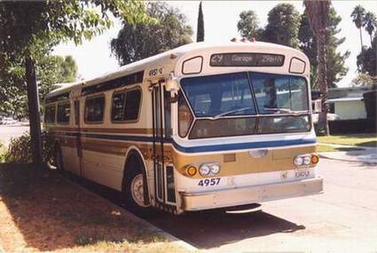

I got my bus out and running on the street a few weeks ago after it sat in the storage yard for about 4-6 years without moving,,an occasional start and idle but no movement due to lack of legal registration. Took it to fill up the tank,,thought it was low on fuel as the last time I drove it,,it was idling strange like it would stall,(never did),but at the station it only took about 40 gallons,out of what I think is 125 capacity. The Flx ran well on that night,but the next week I went back to start the bus,,and it had lost its prime. I changed the Fuel Filters and all seems well again,,I ran it for a bath just last week with no problems. Question is,,When does Diesel start to seperate,go bad,and grow the algae deposits etc? After sitting for so long,,is there something/additive I should add to the tank to kill anything off? The removed Filters werent heavy,,and didn`t seem plugged,,but the fresh filters seem to work better. I want to make sure the engine is safe from any contaminants as I`m not a rich owner and would hate to damage something like an injector with lousy fuel. Thanks for any help Phil / Rt4957 |

I was concerned when the bus would not start due to the lost prime a week after I put fuel in it. I was thinking that maybe I stirred up a lot of bottom of tank stuff upon filling up and then driving it,,hopefully the stuff,if any,has settled back to the bottom of the tank. The bus is located in The San Fernando Vally/California where the weather is usually hot/warm with mid humidity. The tank has a good cap seal on it so I dont think that moisture gets in,,but I am also learning as I go along. It seems like a one time deal after filling it up,,just would hate to get stuck somewhere with an expensive tow bill. That plus you can never have too much knowledge,,things are good to know and learn. Thanks for your help everyone. Phil / Rt4957![](http://www.busnut.com/bbs/messages/233/14302.jpg) |
