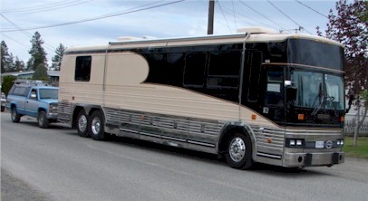

82 Prevost Marathon (same as Champion) 8" roof raise

nice lookin' bus. looks like a 40 foot to me |
