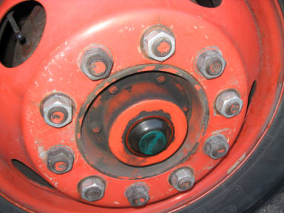

Here is a pic of the wheel with the Budd nuts...and the new and old nuts side by side. The flanged nut has the cone and all holes in the rim are beveled. The only thing is the issue of the flanged nuts not leaving any stud threads showing. I swear, I've gotten some of the worst info from truck repair places! SHould I return it to the original configuration? I'm assuming it's a no-no to not have a few threads of the stud showing?

if the flanged nuts are cone shaped,I would put them on the wheel,, can't tell by little picture,yep, that's a hub piloted wheel...please paint the wheel white or grey...naaaa ....you do what you want with your bus

If I recall correctly, hub piloted wheels have a smaller diameter stud with a different thread pitch. (or maybe I am thinking of something else)! Jack
PS: Looks like a stud piloted wheel to me.

The pix of the lugnuts (with the flat alternating lugs) shows a factory config on a lot of MCI coaches. The wheel is a stud-piloted lugnut design...if the wheel has bevels that match the lugnuts. If so,the lugnuts are correct. You may have a stud piloted wheel on a hub piloted hub?? Studs are different sizes for the two.
You'll see that odd looking configuration on buses. Truck guys don't know this important stuff.
You may have the wrong studs, but the lugnuts are likely OEM. I'd put'em back on the way it was.
I'd also call Luke and see what he sez. It may not make any difference...but be careful changing systems based on truck guys opinions.
I'd make a low-budget bet that the alternating lugs are OEM. Let us know...
JR

The "flanged" lugnuts that Hank described has a cone (in addition to the flange) on the backside for beveled (stud-piloted) Budd wheels. The "flanged" lugs used on hub piloted wheels are different...they have a flat backside with interlocking washers and would not engage the bevel that is milled into Budd wheels.
Hanks lugs are OEM items.
I believe the picture reflects the wrong lugnuts. The "flanged" OEMs have been removed and replaced with standard Budd acorns.
The originals weren't mixed up. They were used in that odd alternating configuration to lower wheel center side loads. Supposedly much greater clamping force.
