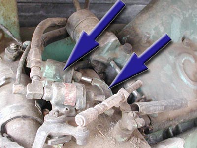

Mark, make SURE that the stop cylinder isn't holding the rack in the stop position. I'm attaching a shot of my old 4106's governor. The arrows show the stop cylinder and rack lever. The cylinder should NOT be extended and the rack lever needs to be up, not down. I suspect a wiring problem might be causing the stop cylinder circuit not to engage. It will never start with the rack shut. It's also good to know where the rack shutoff is in case you lose air and need to kill the DD. Take it easy on the starter AND the start fluid. I had to remove the starter on my 4108 yesterday. It was NOT fun! Doing rings would be even worse. BTW, did you replace the starter bolt? HTH, Brian Brown 4108-216 w/ V730 Longmont, CO presently stuck in Dallas, TX

Mark, check the emergency shut off,or "dump".Might have been "tripped" accidentally. This large electric solenoid controls a metal "flap" or "door" under the air intake housing , on top of the blower.You'll see long shaft on this solenoid and it connects to a piece of linkage that will hold the blower air intake door in the open position (normally).You can manually reset this piece of linkage. Look at the great picture Brian has posted, it's the solenoid mounted on the air intake housing - electrically operated. Good luck. Sammy |

Brian Brown (Blue_velvet)
Registered Member Username: Blue_velvet
Post Number: 391 Registered: 6-2005 Posted From: 76.186.181.86
Rating:  Votes: 1 (Vote!) | Posted on Tuesday, November 14, 2006 - 9:14 am: | |
Mark, the RUN position for the rack is the stop cylinder IN and the rack UP. If you observed it OUT and DOWN, then that's the no fuel position. When you rotate to the DAY or NIGHT position on the front knob, you should hear a bit of air escape (if there's any in the tanks) and the cylinder retract. Again, she won't start in the no fuel position. For the emergency flapper, look for a tab where the wire hooks into it near the bottom left side of the blower as you're facing it. This is not as obvious, but it should also be UP and not down. Trigger it yourself manually (it's got a little detent), to make sure of this. Better yet, pull the bolts around the circular rubber air boot (just above the words GMC on your DD) and look down into the blower. You can see the flapper there. You'll also be able to inspect your blower screen for debris (bird nests, sticks, etc.). HTH, Brian (Message edited by blue_velvet on November 14, 2006) |
