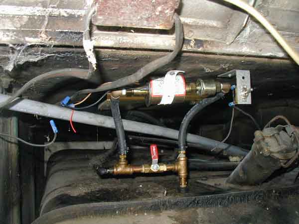

Posted on Thursday, December 07, 2006 - 4:24 pm:
Here is how I did mine. I used a ball valve instead of the DD check valve just because it was available and MUCH less expensive.
The wires are disconnected because I had "borrowed" the pump for another project and I'm just now re-installing it.
Primer pump
Primer pump 2
