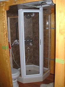

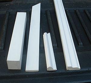

Doug, build your own, there's no better feeling. You can see mine here= http://autos.groups.yahoo.com/group/busshellconverters/?yguid=155252727 . I bought the 32" base at Rv surplus in Elkhart, they have any size or shape you can dream of. I bought the plexi glas and pvc trim at Lowes, I think they call it "No rot" for outside trim. Simply cut the shape you need and glue together with clear PVC glue. I'll send some picture's to I@n and see if he could add them here. |

Ednj asked me to drop these pictures into this thread:
