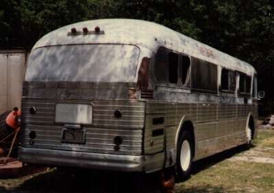

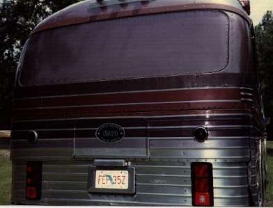

Here is what I did! I replaced the rear glass in my 4104 with .080 3003H14 aluminum, sealed and riveted it to the flange that the window gasket slips over. Total cost under $100 Below might be the pictures if this bbs supports HTML, "that is if I remember how to write the code and if the bbs supports it" Pictures are not showing up in the preview so here are the links. http://www.dishtv.net/pd4104/1.jpg http://www.dishtv.net/pd4104/2.jpg http://www.dishtv.net/pd4104/3.jpg Tom C
