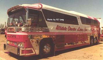

Gus & George - This is entertaining! For the newbies following this thread, let me explain a "dead throttle start". It is not simply dumping the clutch from a dead start. Lots of 18-wheeler drivers do something similar to this with their gazillion-speed transmissions down in double-bottom super-compound low when they've got 80,000 lbs on board. But that's what those powertrains are designed to withstand. However, with a coach driveline, dumping the clutch is a good way to tear it up - big time! With a common coach manual gearbox, it means feathering the clutch gently through the take-up point without adding any throttle until the clutch is fully engaged. Think "finesse". . . Practice with a stick-shift car in a parking lot to get the hang of it. Stop, put into first, feather out the clutch till the car's rolling, put the clutch back in and try it again until you can do it smoothly every time. Keep your right foot off the throttle, just use the clutch. End of lesson for the newbies. . . Now for some more fun & games: Done on level ground, and with practice, virtually every stick-shift coach I've ever driven can get rolling using this technique - including this one, which I drove in the early '80's. A Canadian car originally, it still had the 12V71 and four-speed in it. And boy, was it an absolute ball to drive - almost as much fun as the sportscar 4106! (Allstate had one of those, too, painted in a similar livery.)
Now, before I have to get out the fire extinguisher, let me just add that, altho you could get that MC-6 rolling with the massive torque of that 12V71 and careful clutch action, the unit was a little happier if you feathered the throttle slightly as you feathered the clutch thru the take-up point. Again, finesse is the word here - think of the white dress & red wine! Of course, this discussion is totally inapplicable to those who "stab & steer" - we're talking about "drivers" here. LOL!! FWIW & HTH. . .

Good Morning! RJ says it right again, and thanks for the GREAT picture! I'll post another interesting picture when I get home, and scan it. Its not as good as RJ's, but is interesting to compare sizes. My bus started happily with a little finesse on both the throttle and the clutch, and that's the simple answer. Looking at revs per mile, 20 inch tube type wheels, with I think 12.00 tires, and 22.5 tubeless are essentially the same, just don't quote me on the 12.00 without a book in front of me. NOW, look closely at the left rear fenders over the drive and tag axles in RJ's picture. There is nothing deceptive in that picture, and the tag is not sitting in a hole! The drive tires are 13.5 X 24.5, while the tags are 12.5 X 22.5. NOTE THE HUGE DIFFERENCE!!! The other thing to be noted here, is that Greyhound changed 82 of the hundred to an 8V71T and a 740 in 1973, due to driveline problems. The remaining 18 were left with the V12 for service in the Canadian Rockies. The prosecution rests. (The second post above was done last night, but the wireless network was down where I was last night, so nothing to do but save it till morning.) George (Message edited by George Mc6 on July 25, 2008) |
