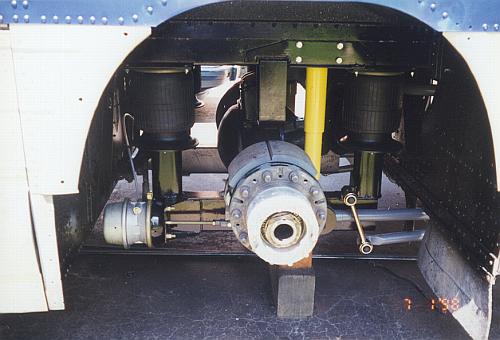

Special note: This photo is not of my bus, I only wish it was. GM4106 spring brake conversion:
http://webpages.charter.net/schula/bus9.htm Taken from: http://webpages.charter.net/schula/index.htm |

When installing the spring brakes, make sure you have room to install the "cage" bolt. (It retracts the spring mechanically, no air needed.) Otherwise, towing it may prove interesting.  |

At normal ride height there is very little to no room to access the cage bolt on a 4106 that has been modified to spring brakes. The reason one needs access to the cage bolt is that it allows you to back off the spring so you can move the bus or work on the brake chamber (There are other ways around that, but it requires a lot more work, time, etc.) Depending on what type of leveling system you have, you can raise the bus a few inches to obtain access to the cage bolt. Without a leveling system, disconnect the leveling valve rod and manually adjust it to accomplish the same result, you only need a few inches. For those reading this that might not be familiar with air ride buses, it is absolutely life or death critical, that you properly block your bus up while you are under it. Also, do not work on the brake can unless you have educated yourself on the dos and don’ts. That spring can make them as dangerous as a cocked pistol if not handled correctly; it can maim and kill also. |

Barn Owl; Is that a new 4106 or what? I ain't seen one that clean since I went on a tour of a conversion company in Indiana. Wow that is cool and I do like the set up. When I had mine they didn't make anything that would work SAFELY and I would not take a chance. Gomer |

Marvin, I think that picture came from Al Schultz's (Southern Wis) bus, he did the work himself, and the rest of it is that clean also, check out the link by the pictures. Jim |

Gomer, I can honestly say I have never seen a GM that clean. I truly don't know how people do it. Laryn |

I checked out the pictures of the coach and that is awsome. Was he totalled retired? I barely have time to work on mine let alone wash it LOL If you haven't seen the pics GO DO IT NOW!!!! You will be ashamed of yourself after that. Gomer |
