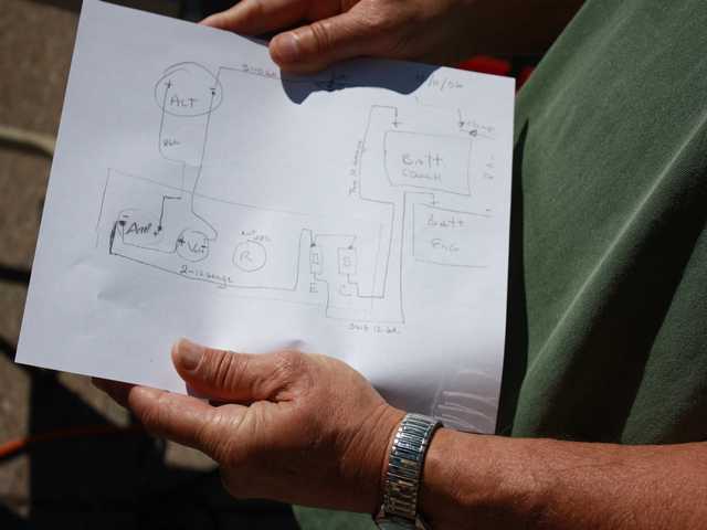

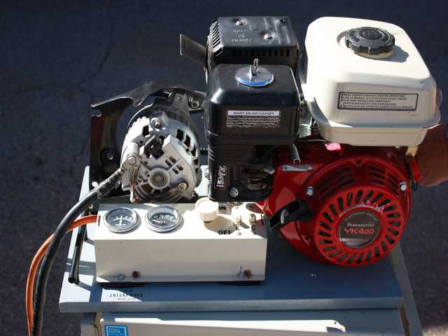

A couple of thoughts on the electrical system here: One horsepower produces 746 Watts, 105 Amps at 14 Volts is only 1470 Watts if everything is perfect, so lets say it takes 2 1/2 hp to produce 105 amps? "Really drags down the engine with both switches on." ? (Less than 65 amps, more or less, output if #12 wire.) Something's wrong here! Lets say the extension cord used is a 14/3? #14AWG is rated 15 Amps, which would give a maximum output of 45 Amps, without smoking the wire. A #12 cord would only increase the output to 60 amps...? He IS using the resistance in the wires to control amperage, which just happens to be the exact function of an electric heater. Now, before you jump all over me, BECAUSE the alternator is self-regulated, it only keeps 14V on its end of the wires, regardless of the current flow. Since I guess he hasn't had a fire, that isn't too much for the wires, which means he isn't putting more than about 50 Amps into his discharged batts at startup, with #14AWG. IMNSHO, he would have been far better off, and safer, to have used one piece of #3 copper. This would let the alternator put out its full output as needed, and since it is self-regulated, it wouldn't overcharge anything. Is a small DC alternator more fuel efficient than running a 10KW 120VAC genset that has to be transformed into 14VAC and then rectified into 14VDC? HECK YES! (As long as it isn't run at 1/3 output for a long time.) Current limiting with rubber-covered wires is dangerous! George |

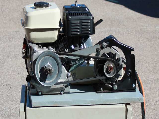

Here's some pics.
Best regards, dg |
Post Number: 593 Registered: 8-2006 Posted From: 76.91.197.153
Rating: N/A Votes: 0 (Vote!) | Posted on Saturday, October 18, 2008 - 5:23 pm: | |
Doyle, Thanx for the pix. The reason the alt is slowing the engine down, is because of the pulley sizing. Presently the alt is running about twice the engine speed, and the engine may not be capable of 1470 Watts at partial speed. Also, it may not be governed, and if not, its speed will vary inversly according to its load. The orange output cord is definitely either a #14, or a #16, limiting the output to a maximum of about 50 if its #14, or 40 if its #16. With a pulley change, and a wire upsize, it ought to be good! Regards, George |

Soooo, do I understand that if I run my 6.5 hp motor at about 1/2 load (speed)(1750 rpm) and run a pulley that's 2 or 3 inches in size on the motor (approaching a 1 to 1 ratio with the alt) with a single 6 or 8 gauge wire...(to each side...+/-...) I should get my 105 amps of charge at the batteries???? dh |

What's with the hose clamps on the engine pulley? |
Registered Member Username: Texasborderdude
Post Number: 146 Registered: 3-2007 Posted From: 75.211.82.114
Rating: N/A Votes: 0 (Vote!) | Posted on Sunday, October 19, 2008 - 4:19 pm: | |
Quartzite repair 101. The pulley cracked from belt vibration, so he made a temp repair with the clamps. Now has a replacement pulley, but is waiting for it to fail before replacing. |

Doyle, In a word, yes. Whether Fred likes it or not, one horsepower generates 746 Watts. However many amps that is, depends on how many volts its generated at. So, 105 amps times 14 Volts, which is just normal output voltage of an alternator, is 1470 Watts. Divide that by 746, and it will give you the horsepower required. Its two, but everything isn't quite perfect, and there is belt friction, etc, so in reality, it probably takes 2 1/4 or so. Will your six horse do it easily at more or less half throttle? (Answer is above!) #6 AWG is rated about 70 amps, and I wouldn't use anything smaller. I hope this helps, again thanx for the pix, AND the re-position, whether it was you or the Canuck that got there first! Regards, George |
