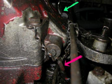

Post Number: 1461 Registered: 12-2000 Posted From: 76.71.102.247
Rating: N/A Votes: 0 (Vote!) | Posted on Friday, January 16, 2009 - 11:07 pm: | |
ok, here's the emergency stop:
This is looking in from the rear in an MC8, at the top of the air intake leading from the air cleaner to the top of the blower. The red arrow points to the little handle on the emergency stop device. The handle needs to be pushed down, such that the clip arrangement over at the green arrow engages to hold the flap that is inside the cover stays open. Sometimes, the clip arrangement, which is attached to the electric solenoid that pulls the clip to trip the flap, needs some help by your finger to go into place. This device is intended to let an observant operator try to stop an engine that is running away uncontrollably, due to some failure of the fuel delivery system. It does this by choking off sufficient intake air that the engine either stops or barely chugs along. The purpose being to prevent the engine from running at such uncontrolled high RPM that it damages itself. These failures are due to poor maintenance of that system, re-using parts that should have been discarded, or ignoring the signs of a failing system - sticking, or otherwise uncontrollable moments of engine fueling. I don't have a good pic of the fuel shut off arm to show you where to put your finger to shut the engine off manually. Who does? happy coaching! buswarrior |

Mike, with all due respect..... Nellie...... do not do that. wait, let me say that again:
NELLIE, DO NOT DO THAT. Thanks Mike. No hard feelings, OK? |

Post Number: 1470 Registered: 12-2000 Posted From: 76.68.132.217
Rating: N/A Votes: 0 (Vote!) | Posted on Monday, January 19, 2009 - 11:26 am: | |
The promised pics for shutting off the engine via manual methods, and resetting the emergency stop have been posted on a new thread entitled: Manual engine stopping V71 happy coaching! buswarrior |
