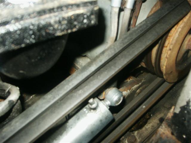

As some of you know, I finally got 'Nomad's Land' (my bus)'running and airing up again. But while monitoring the air pressure, I noticed some psi loss when there shouldn't have been (no air appliances were being used). I walked around, listened for leaks, but heard nothing. After I shut her down, I opened the engine compartment to cover her with a blanket (I always tuck her in for the night) and hear psshhhh. I located the leak... it was dark so I couldn't tell for sure, but it seems NOT to be from a line or a valve. The air is escaping from the 'business end' of the piston that tensions the belts to the air conditioner compressor. I'm going back today to check that, but here's my question: Regardless of exactly what is leaking, and since I've decided to remove those belts anyway, can I simply plug the air hoses that feed the piston and deal with the leak later (when I put the air conditioner back into service)? To better explain, I'll try to upload a photo of this piston.
Wow! That was fun... never posted a picture before. Now I can just go wild... expect a lot of future photos. Thanks, Nellie Wilson |

Go ahead and remove the belts and disconnect the line to the piston and cap the air line. It is no problem at all. Before you do, give a listen closley to see if the leak is from the air line/junction, or if it is air leaking from the piston itself. Good Luck! Glenn |

Glenn- The leak is definitely coming from the piston. I had a buddy (Neil) come over. Neil's no bus guy, but he trained at Detroit Diesel back when Heck was a pup... back when the 8v-71 was DD's state-of-the art power plant... and he's been truckin' or wrenchin' ever since. (Except when he backs me up on his INCREDIBLE drums). He reckons there's less than 10 psi supplying that piston. He also questions whether the 'leak' is actually an OEM exhaust? The hole expelling the air seems machined (as opposed to rusted or corroded). Neil suggested I ask you guys if an operational A/C is necessary for the coach heating, defrosting, etc. What he's saying (in a nutshell) is to 'Avoid major modifications before a long trip - unless you're absolutley sure what you're doing.' Well, I'm not ABSOLUTELY sure. And Neil reckons the 'leak' (if it IS a leak) is so small it's hardly worth messing with... at least for now. Whatta ya think guys? I'm pulling out on Thursday... Nellie Wilson |

"Would you know if doing this (disabling the A/C) would interfere with OEM coach heat or defrosting? I'll be Florida-bound soon" Nellie, Your bus heat and defrost will work as long as the 2 water valves in the engine compartment are open. Right now you will need that bus heat in Florida (at least for the next day or 2). Jack |

If the leak is as tiny as you say, I'd leave it alone. Gotta remember when bus is running there's always an air suppply to keep tension on the belts. You can always spray some "Magic Leak Detector" (soapy water) on it to actually see how bad it is. Best of luck. |

Inside that cylinder is a spring that will provide some tension on the belts even if the air all leaks down. When air is up, that cylinder is supplied via a regulator mounted at the control valve so the belts are tensioned correctly. MCI operating procedure state that the belts can be removed during winter after the AC is pumped down and isolated, so there is no problem doing what you suggested - remove belts and cap off the air line. There should be no significant air leaking out of the rod end of the piston. Needs new piston seals. There is one air system that does have a machined hole to provide constant air leakage - the left hand cylinder of the radiator blower outlet shutter (controlled by the airstat on the pipe running coolant to the LH radiator) has a controlled leakage so the shutters will open when the temperature rises. Otherwise they would stay shut forever. |

In the MC 8 manual before clutches came to the A/C conpressor you were to put the compressor to bed by 1. pumping the refrierant into the dryer and shunting the valve (to prevent leaking out the compressor pully seal while shut down)2. removing the two belts. I did do number two when driving in that first winter to save the wasted power of turing the dead headed compressor and all that "do nothing" wear & tear. Did not effect the heat system funciton at all. The third procedure was to discontect a wire on the system (like the A/C high/low/off switch to prevent the system from running the big 2 hp condesor fan for no purpose, if you misaplied the A/C control switches (something one of the dogs likes to do when pretend driving, that and the signal switch) Gee way to post pictures Nelle, I still haven't mastered the resize thingy to enable post a bus's profile picure, not even after downlaoding infaview device. Guess it is all in the way you were your blue boots! Even resorted to asking Ian for direction, sometning guys just don't do, you know! |
