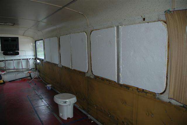

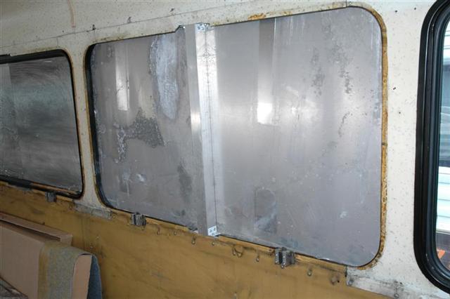

When blocking out the windows is there usually 1 peice of metal on each side or is there 2 peices, and a seam. If the is a seam do you overlap it or just butt them together, and have them filled during paint? Thanks! |
Bill Gerrie (Bill_gerrie)
Post Number: 246 Registered: 3-2006 Posted From: 216.198.139.38
Rating: N/A Votes: 0 (Vote!) | Posted on Wednesday, April 15, 2009 - 8:07 am: | |
Dustin Usually you will cover the window openings with one piece of metal. If you use two pieces over lap them with sealer between them. You don't want water to penetrate to the inside. Use metal thick enough as well. I used 14 gage as that is what I had. A little heavy but strong. If it is a large opening you might want to reinforce the joint with a piece of angle iron inside. Just remember to not let steel and aluminum touch as they will corrode with electrolices action. Coat the metal to prevent contact. I used duct tape between the sheets if I could hide the joint then sealer. Cheap and works well. No problem after 20+ years. Bill |
