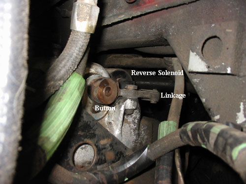

Nellie - To answer your question, the reverse solenoid pulls on a lever mounted on the top of the transmission when activated. This lever, in turn, moves the internal gear selector to reverse as you pull the stick up front into what is normally the 2nd gear position. It's been my experience (IBME) that some MCI's like to be shifted into reverse the same as the GMCs (start in 1st, push/hold button, pull back into 2nd, release button), and others prefer you start in neutral, push/hold button and pull into 2nd, release button. Dunno why, as most 4-spd MCIs all use the same Spicer 8844 gearbox. Here's a pic of the reverse solenoid on my 4106. Notice the lever it's connected to, that is what my friend pushed on. Easy on a GMC, because it's right inside the transmission access door. If you look in the upper left, you can see the round wheel used to adjust the clutch, and below that, one of the shift linkages. The funny-looking thing with the springs on it is the "mousetrap", officially known as a "clutch assist mechanism". Your MCI uses air, GMC used simple springs. You should be able to see the reverse solenoid on top of your transmission, most likely on the passenger side. FWIW & HTH. . .

Thanks RJ - Good photo, great explanation. I'll pull some covers off and snoop around, maybe try to shift it into reverse manually? Just some 'in case' training, you know? Nellie |

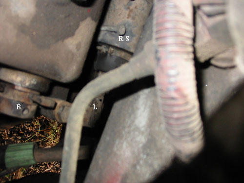

Here is the reverse solenoid looking in the Passenger side of the MC5A at the Transmission
Here is the reverse solenoid looking from the door on the floor in rear and forward of the hole Can not reach from here |

Thanks Rob, I'll check it out in a near future. Nellie |
