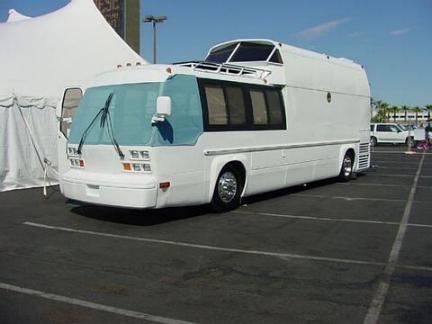

This double RTS is intriguing. I've heard mention of it. Does anyone know where I can get info on this monster? How badly does it hobble the bus in the handling department? |
Pete RTS/Daytona (68.128.144.243)
Rating: N/A Votes: 0 (Vote!) | Posted on Thursday, February 13, 2003 - 8:34 am: | |
Hmm - let me see if I can post a picture from the Yahoo-RTS-bus-nuts photo pages

Pete Plaskove was the builder who raised the suspension and floor. I saw it at Pete's house before he sold it to Marv Gunnafson (Tustin, California) who now has the chassis and is putting it back together. Pete pretty much stripped the hardware out of it so a lot of fundamentals had to be replaced. About the S-50 installation in the RTS, the reason (probably true!) the chassis cracked is that the vibration on the 4 cyl engine is so severe, due to an approx 11 litre engine, 4 power pulses instead of 6, and the inherent vibration characteristics of a 4 cyl. engine. This type of swap needs much softer engine mounts. The MCI S-50 installation allows total travel right to left at the top of the engine of about 4" according to my sources. The RTS chassis would have to be reinforced in addition. There is room for a 12V71 in a T-drive configuration. The original RTS design study received a contribution from the military for a 4WD-AWS Troup Transport version using that engine. The prototype worked well but couldn't pass the sideslope test. Onward and Upward (The original...) "Marc" Bourget |
