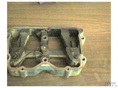

Posted on Sunday, September 07, 2003 - 6:17 pm:
Here's a picture compliments of ebay, of a typical Cummins jake brake. This one is for two cylinders of a 6 cyl engine. It takes three of these in this case. They all look kinda like this...
http://www.heartmagic.com/jake.JPG
