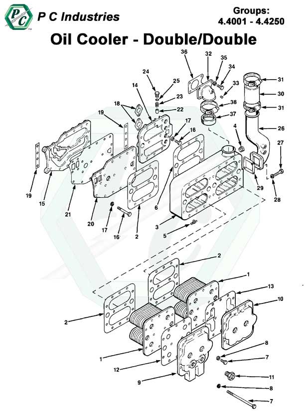

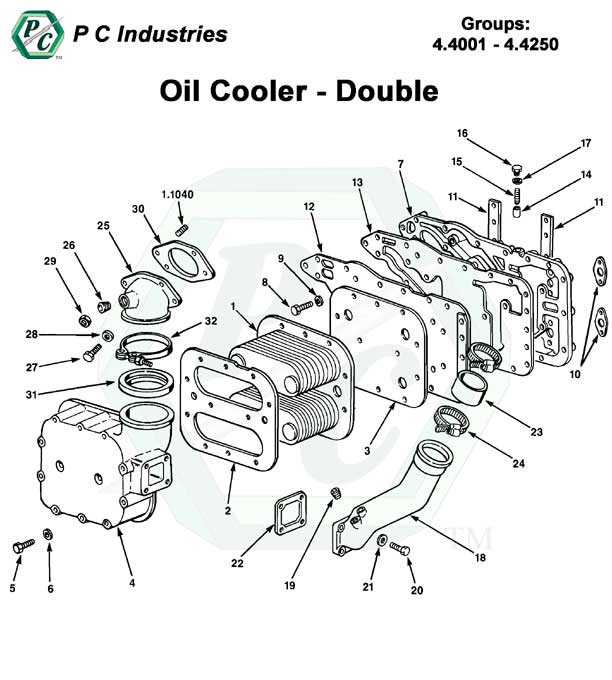

Brian, Why remove the double-double oil cooler? The cooler you can keep your oil, the less load on the rest of the cooling system, and by extension, the engine. Turbo engines need lots and lots of cooling, and everything you can do to help this is good. Your double-double should look like this: http://www.powerlinecomponents.com/catalog/img/PCI/pgid/346/V71_oil_cooler_dual_double_pg1 51-154.jpg If it's a 'single' double oil cooler, it will look like this: http://www.powerlinecomponents.com/catalog/img/PCI/pgid/342/V71_oil_cooler_double_pg147-15 0.jpg The standard 8V71NA with a standard transmission will reject a lot of heat through the cooling system and the oil cooler. Add an automatic transmission, and you can go to well over a million Btu/hr. Toss in a turbo, and you have a disaster waiting to happen. Good Luck! and welcome to the board! |

Dallas those are automotive coolers Brian's industrial engine had a different type cooler the stacked type I doubt if he had a enough room to leave those |

Hi Dallas, Clifford is right, the oil cooler was too big to leave on. It required a remote oil filter housing that I didn't hve, and some of the plumbing was missing. I thought it best to use the standard one, and I am retaining the spicer gearbox. Bill, if I think I can use your cranes I'll get in touch. I actually think I have a plan figured out - time will tell... Brian |
