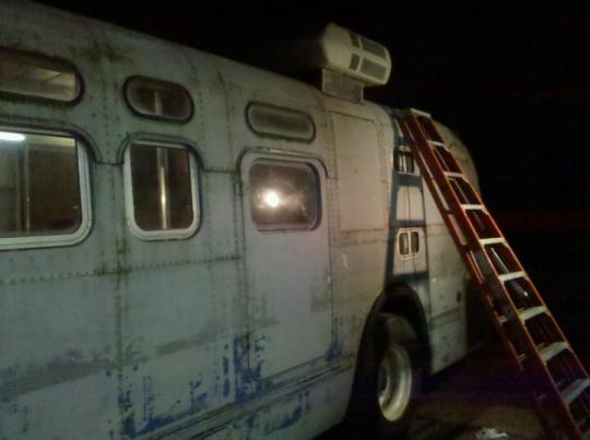

HELLO FELLOW BUS NUTS! I have some photos of it stuck in the dirt. It was so buried that it wouldn't power out.

Rating:  Votes: 1 (Vote!) | Posted on Monday, March 28, 2011 - 8:13 pm: | |
Another pic:

Rating: N/A Votes: 0 (Vote!) | Posted on Monday, March 28, 2011 - 8:46 pm: | |
Brandon, The last pic is the best! You've got your work cut out for you, and you've done a lot already. I would like to make one strong suggestion, convert it to negative ground!!! Positive ground entails insulating ALL of your electronics from the frame, then running a hot wire to each insulated case, and running the appliance's hot wire to ground. Positive ground means that you will have to reverse the wires on anything plugged into a cigarette lighter type power receptacle. Making a successful positive ground inverter would be a nightmare. Welcome, and good luck. G |

Rating: N/A Votes: 0 (Vote!) | Posted on Monday, March 28, 2011 - 11:45 pm: | |
Wow! That mossy top made for an awesome photo! That will be one cool ride when your done. Love the pics! |
