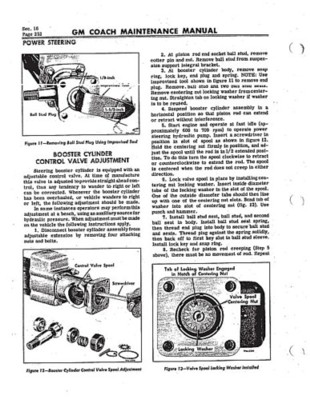

On my 4104 I have the Power Assist Steering with the Hydraulic cylinder. I have been noticing lately that the bus wants to steer slightly to the right. So I decided to check out what was happening. With the front of the bus blocked up front wheels not touching the ground I started the engine and the Power Assist slowly turned the wheels all the way to the right. I'm thinking that the directional valve may be leaking internally... What are your thoughts??? . |

Austin chek DA BOOK for adjustment on the actuator valves and maybe the clearance is out just a little. If that doesnt work DA BOOK will give you a guide to follow Gomer |

Got it... Page 252 of my maint manual... That's a bit of disassembly just to get to a adjustment screw...

Hey Zim, Had the exact same problem with my coach... took it to an alignment shop to no avail. It is in need of the adjustment that you are looking at. I cannot remember what all had to be disassembled, but it seems that the ram had to be separated in order to get to the adjustment done. I remember having the front wheels off the ground - and with engine running at a fast idle - fiddling with the adjustment (with tires going right and left) until finally getting it nice and straight ahead! It made a big difference and no longer pulls to the right.... now it just wanders all over the #$%^&*@ place! lol! Seriously, it is better, but I have since purchased a Sheppard steering set-up that I hope will tighten things up a bit. I've not yet installed it. I've heard lots of folks on these forums say that it helps a great deal, and a few that say they couldn't tell the difference (talking about integral vs power assist) in steering. One gentleman in particular owns (or owned) two 4104s - one with power assist, and one with integral power steering and said he couldn't tell much difference. Don't know about yours, but the steering on my Ol' Mare is pretty vague. After eleven years of continuous use I'm pretty accustomed to how it behaves, but I am hopeful that the integral power steering will improve things a bit... less wander, less effort turning the wheel, quicker steering, etc. Good luck. I just followed the book as you are. Kevin |

I crawled under the bus this morning to get a good start and cannot get the drag link off at the cylinder end... But During inspection before working I did notice that when I turn the steering shaft the cylinder ball did not seem to move side to side very much to activate the valve. After trying to remove the drag link (prying,pounding and such)I gave up on that and noticed that the cylinder ball now moves side to side better... I think that the cylinder ball may have been stuck to one side. This may have happened when I made and replaced the Extension end. That is when I first noticed the pulling to the right. I will be checking to see if it pulls to the right soon. I also noticed that the steering shaft has one U-Joint that is a little sloppy... (A job for another day) While I was under the bus I hit every grease fitting with a few squirts of grease. I hadn't done that since I first got the bus 5 years ago. . |
