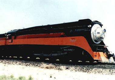

Can't find a pic of an EMD FP-9 in "Daylight" livery, but will this do:
4449
Have a nice weekend, everyone!!

Gary McFarland (Gearheadgary) (68.79.116.133)
Posted on Friday, September 03, 2004 - 10:41 pm:
Give the man a Cigar!
I could only find a pic of a lionel.
FYI: I was a member of the NRHS (National Railway Historical Society) that put the 4449 back on the road.
We chased her from North of Eugene all the way to the Siskiyou summit on her maiden trip to Sacramento.
Gary
