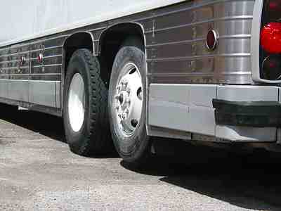

My left tag is acting just like a hound dog whose back leg was caught in one of Two Dogs' rat traps. I would *never* have thought that the trailing axle wheel would actually lift up and clear the ground by 1.5". That's what my left tag wheel is doing. It's up and it ain't going down. Do the bags actually have springs in them which pull the arm UP???? Naah. Couldn't be, huh? Or could it? If someone took a knife and stabbed the tag bag, my assumption is that it would just be useless weight rolling along, but it would lift UP???? Before I schedule an MCI appointment, (Yike$$$$$) surely this isn't a soap-n-spray bottle kind of issue, or is it? Could it be 'stuck up'? Might I have taken a steep slope at a wierd angle and caused the shock to stick? This coach does not have the optional trailing axle unloading switch. I did turn the valves on and off for both sides and they sounded exactly the same as pressure was cut off, but no change in wheel position. Any ideas? The shadow's so strong that I'm not sure you can see how freakish the tag really looks.
![gimpytag](http://www.busnut.com/bbs/messages/233/6978.jpg) |

I can see it...real clear...good photo...think you have a bushing problem...not too cheap |

I have to agree with 2 Dogs. The tag axle bushing in probably froze up. This is a bronze bushing that is a snug fit in the cross-over tube that is bolted to the bus frame. Replacing it is definately "Bull Work". Give Luke a call 1 888-COACH34. He can explain the procedure and has the parts available. I replaced one of mine. Hope this helps, Jack |

If you need to remove the arm and inspect/correct the bushing, rather than loosen the joint up, read on. To remove the arm, you should remove the wheel, brakes, and fasteners. This will lighten the arm weight. To remove the arm, you may need a porta-power to pull it out. Ed Roelle Flint, MI |

This is a case where, if one side is bad, the other side is too. You're looking at $850+ in parts and a long day's labor on each side. You will also want to find a shop that has done this before. The old bushing needs to be chiseled out and the shaft welds ground and then the shaft pressed out with a 50 ton press. New parts need to be shrunk with dry ice to put them in. As it is right now, the bushings and shafts are rusted together. If you can grease and loosen them up, you will probably have tag axles that are way out of alignment from the rest of the bus. This can cause handling problems and excessive tire wear. With tires at $400+ each it won't take too long to pay for the tag bushings and shafts. Jim |

you could try liquid wrench on the bushings....know it has been parked for quite a while |

Ya know, before I start cryin' in my beverage I'm gonna try a few dumb luck things like that. I know it hasn't always been that way since I've had it, and in a drive a month or so ago I had to negotiate a wickedly sloped fuel station entrance at a sickening angle. So maybe it somehow went out of limits and stuck at that time. You should have seen me yesterday trying to jump up and down on it. Laughable. From what you guys have described, I know it's too much of a bull work job for my meager space/time/tools. I know, I know - I've read it dozens of times from you guys - "You're playing with the big boys now." Compared to Gary's and others recent mishaps, I just have to sigh. So if it is a trip to MCI, we're talking many thousand $$$!? |

don't know if you can bust them lug nuts off...that is a chore without a 1" drive air wrench...after you get the tire off...wet everytng that moves ...or should move ,use that little nozzel on the side of the liquid wrench can...I have a number of a mobile flat guy in Dalls,he might charge you 20.00 to come out & bust them nuts off |

Chuck, When I bought my MC-8 from Hausman Bus (MCI) at Los Alamitos Ca, I had them install new tires, replace an air bag and a few other items. Everything they did came out at less than the estimated cost, if I had known, I would have had them do a whole bunch more items whilst it was there. Peter. |

after you get everything good & wet....put a bottle jack between the frame & the axel... |

try that bottle jack like I said...then after you get it unstuck,grease the shit out of it.... I said: .....YOU GOT A BUSHING PROBLEM.... I didn't say they were worn out ya' want me to come down for a few days ?? |

I've known 4-5 people w/MCI's and this problem. Never known any of them to have to do anymore than replace bushings. A lot of work, but not bankruptcy. |

For my money, as a diesel mechanic of 25 years, I'd try to re-lube the bushings and try to free the axle up before I did anything else. It is obvious to me that at some point you went over something that lifted the tag that high. If you can bring the tag back down, you might find that you can lube the axle easily enough, and the tag might then operate normally. WD-40 seems counter-intuitive, but at the very least it couldn't hurt. Install new grease zerks and try to get the bushings to accept grease If no grease goes, you will need to move the tag down first. Brian |

Followup - Went over to MCI today and they gave a SWAG of $1K per side, parts & labor. Will probably have them do the job. I wouldn't be afraid to tackle it, but without the facilities/resources I think I would need I'd wind up with a pile of parts in trouble. Those guys are great. I got a full explanation of exactly what's involved and he elaborated a bit more on freezing the bushing/heating the tube. Once ready, he said you've got about three seconds to get it in and get it in just right. I'm not that big a gambler! I think Two Dogs is right - the greasing probably hasn't been done since it left greyhound (although I'm not sure it ever was one) Years of crud came off today and I discovered the remote zerks that Jack mentioned. I was successful in filling the top one, but the bottom ain't accepting donations. I did decide to leave the body blocked up slightly overnight, wondering if many hours of hanging there would cause it to just drop down to da ground. If anyone's still paying attention to this little tale, what would you think the arm, fully loaded, weighs? 500-600lbs? So in a few months I'll update this thread once again. Thank you all over and over again. It helped *tremendously* to be able to talk to MCI and have a pretty accurate idea of his description of the process. AND it is a MORTAL SIN and heinous crime against Busdom not to lubricate those fittings! This is an issue that should go in the "what to look for when buying a coach" files. In all the reading I did, I never encountered this one. |

take that zerk out that won't accept & get some wire & dig out the hole & douche it with liqid wrench ,put a new zerk in (.50 )...& grease it & get a jack in there & force the axel down...unless those tires are wearing funny,not sure you need new bushings |

Chuck- Be prepared for a suprise when they get the tag axles out. When they see what is in there they might call you and recommend that the shaft be replaced too. If the shaft is pitted and rough, the bushing won't last long. I wish you well in this. Jim |
