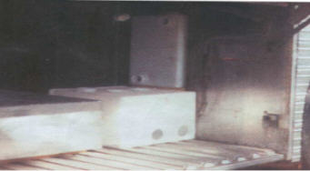

If you have a copy of Bus Conversion Magazine, February 2004, on page 32 is a picture of my gray water tank in the air conditioner hole. That should give you an idea of where I mounted them and what I'm talking about. No, I didn't insulate the holes. I've been in 14 degree weather and the lowest my back bay temp got was about 55. It is heated.

David Anderson (168.215.176.180)
Posted on Thursday, October 07, 2004 - 3:58 pm:
Well, it came out, but my text was gone. This is the street side air conditioner hole. You can see the 48 gallon gray tank in it. The black tank is below and in front of it.
The gray has 2" inlets/outlets. The Black has 3" This is the picture from the magazine.

I see three tanks, the one to the right is higher than the two to the left. Are the two spots on the side of the middle tank your 3" outlets?

David Anderson (168.215.176.193)
Posted on Friday, October 08, 2004 - 1:36 pm:
Marc,
The upper tank is gray. (There is another on the other side of the coach). The lower tank with the 3" outlets is black. The tank adjacent to that one is a 135 gallon aluminum diesel aux tank for my genny, webasto, and an on demand pump feeds fuel to my main tank. I can go 1500 miles without stopping.
My black tank has a flat bottom. The 2 gray tanks dump to it. I've never had any difficulty discharging my waste since new.
