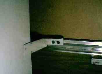

I'll see if I@N feels like posting a picture...my refer is SOLID |
Rating: N/A Votes: 0 (Vote!) | Posted on Thursday, February 03, 2005 - 3:18 pm: | |
By the request of Mr. Dogs, a photo of his reefer securement.
Uh, I'm not sure which way is up, so hope this is right.  |
Rating: N/A Votes: 0 (Vote!) | Posted on Thursday, February 03, 2005 - 3:27 pm: | |
that is correct Chuck....brackets are on both sides...halfway up...it has not moved since instalation.. |
