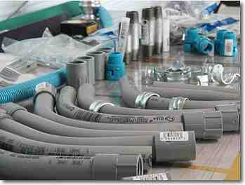

Hell, a guy can spend fifty grand on plastic pipe and fittings, alone!
Username: Chucks
Post Number: 1104
Posted From: 70.3.106.204
Posted on Friday, April 20, 2007 - 12:52 pm:
...and that was just fer water.
another 50 fer elec conduit! ;)
nmc
