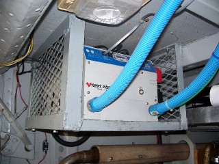

I would install the inverter in front baggage compartment (close, but separate as well as dry and adequate air circulation. It can be installed in a "cage" attached to the ceiling. JackInverter Cage
