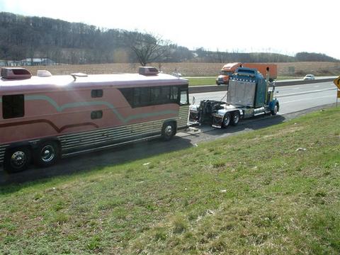

Just saw this thread, and had a towing experience a few years ago. Had the primary fuel line swell up on the inside, so had a slow reduction of power over about 2 hours on the road, and I thought was filter related, but then she cut out trying to start on a grade and would not re-start. A real tough one to find. Got towed by Zores towing in Indianapolis, great people, lifted from the front axle, had to back of the brakes as I did not have an auxiliary air point (I did the next weekend). Towed us the their shop, and gave us access to all their facilities so I could fix the bus. They even help me re-adjusted the brakes once they had towed us, and made up a replacement line when we finally found the problem. Just charged me for a standard tow. Picture on our web site:
http://www.chachingracing.com/chachingracing1_009.htm
