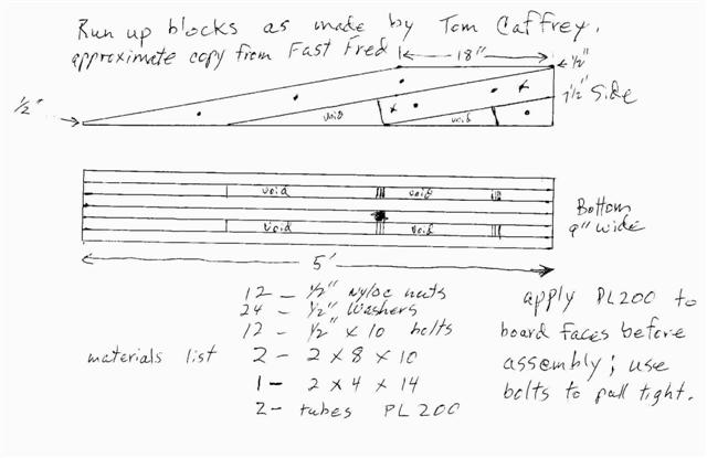

Okie Dokie, here is the email in it's entirety: thanks dosdogs1 appreciate the input. what I did: get a sheet of plywood 4x8 ................ wait...ok you park your bus same place at home..right ?? put the piece of plywood under there,under the engine/axel area....pull bus forward..mark around plywood ,rent a trencher,dig a 3" wide trench two feet deep around those marks,fill with concrete.next day,dig all dirt out two feet deep.....next day,pour cemente pads for drive wheels........bus can't fall because it isn't UP |

Below is a link to a ready made pattern for some blocks that we like well enough to have two sets. One stays in the bus and one stays at home for all of the rest of our equipment and vehicles. http://f1.grp.yahoofs.com/v1/MM3WSW0JeuDDAfYYuDPDVQV-WeLaES6NPzsJ6NTWGW0b02hFBj0t2dhXDa7KK c41rAtUjPxHvj8lquBdMO1fWy_Hia4/Run-up%20blocks/Run-up%20blocks.jpg You might need to register with the GMC Yahoo group to access this page. For what it's worth. Tom Caffrey PD4106-2576 Suncatcher Ketchikan, Alaska |

Someone on the 'other' board has a diagram that shows how they made their own. Jack |

I think this is the one. I hope this well help. (Message edited by bob4106 on April 05, 2009) |

Thanks, Bob. We like ours very much. The voids are used as hand holds and I think that ours weigh about 40 pounds each. They are made of douglas fir, but spruce would make them lighter. These nest in the bay very nicely. Tom Caffrey PD4106-2576 Suncatcher Ketchikan, Alaska |

I selected 2x8 as the material, and a 1/2 rod cut to sixe + nuts and washers was cheaper than long bolts . Construction glue is a cheap insurance. Fits (just) when aired down. FF |
