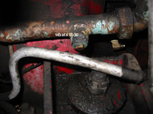

Was cleaning ground block for engine on the cradle side of motor mount and saw this wire going now ware so I looked and it had a hood like a battery cable on the +battery and saw this on the water line and think did this go on this whatchamacallit
????? any one know???? don't see it in DA Book and saw nothing I could find in DA Archives! Rob |

Rob can you add a better Pic, is the wire the one in this pic that is behind the silver pipe and what is the copper pipe in the pic. Dave L (Message edited by Dave_L on September 26, 2009) |

Is your starter to ground block and starter ground to engine block? You need to have a 2/0 from the frame ground/batt- to starter than starter to engine block with a # 10 or larger. |

Suggestion.....Clean the area first...then retry the pic... RCB |

Looks like the "fitting" directly under "Whats This" is a supplemental drin plug for the cooling system. Jack |

Thanks Jack I think your Right! David yes that was the wire I found the copper pipe is the water pipe going to the solenoid valve for the old Bus heater removed now! the silver tube is for wires! Ralph the Starter and starter ground is on the other side of the bus and is #00 and starter to engine is #6 this is a pic of the drivers side The DN Alt Belt driven is just farther left in the Picture. Nelie what did you use to Clean off all the old Yuck in the hard to reach places? I Don't want to use to much presser around some of the old wires and the old presser lines. |
