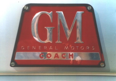

Rick -
RE: Breastplate Emblems
Coaches ordered by Greyhound from GM all received the running dog emblem as a breastplate. Many were removed when 'Hound sold the coach to second-tier operators, but others survived. They show up now and then on eBay and other places, but are becoming rare.
The red GM breastplate, like the one in the photo below, was the OEM unit for all non-Greyhound coaches. Most have deteriorated so badly by now that owners often remove them. There is a fellow who made some vinyl decal duplicates for awhile, don't know if they're still available, but can find out.
The sliver GM letters that you have on the front of your coach in the photo are the same OEM letters used on the 4106s. They were never on the '04s from the factory.
FWIW & HTH. . .

Anyone have a picture or two of the oval Greyhound emblem on the breastplate? Any one know the history on it?
Thanks!

Rj.. and the rest of you smart or lucky enough to own the finest coach ever made in America
(the SPORTS CAR of COACHES)
THIS badge/ID Plate is actually quite easy to have reproduced,
it just requires a bit of legwork to obtain..!
ANY Trophy seller with a Laser Engraver
can simply scan it into their computer & Laser cut & engrave it in Plexi-Glas or Perspix
(NOT Lexan or Polycarbonate)
Then all you have to do is add the color , in paint, to the reverse side... a PERFECT duplicate.
( Hint: anyone who paints their fingernails can do this with one eye open )
Depending on the greed factor of the Trophy shop,
this can cost you as little as $30 or as much as $80 but you will have EXACTLY what GM mounted on the front of your Coach.
All you need to acquire is
an original or a PHOTO of one
AND
an 8 X 8 inch scrap of 1/4 or 3/16ths PLEX
which should be available for free from a Plastics Warehouse...
if you don't have one handy
drop me a note & I'll be HAPPY to send one along gratis..!
such a deal ...eh?
Username: Chessie4905
Post Number: 2123
Posted From: 71.58.71.157
Posted on Saturday, July 30, 2011 - 9:43 pm:
more like 1/2 inch thick and the lettering looks to be chrome plating, not paint from the one that was on our 04. It was a new replacement and then the plastic started to show what looked to be internal cracking.
