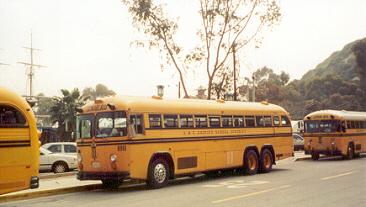

OK, gonna try posting a Gillig pic again. . . and, if it works, also a Crown. This is for Two Dog's benefit, so he understands we're not talking about conventional skoolies:
Rating: N/A Votes: 0 (Vote!) | Posted on Thursday, December 09, 2004 - 1:17 am: | |
OK, that worked, let's see if the Crown pic will. . . Both of these, Two Dogs, are 40' tandems, mid-engined, either a Cummins or Detroit, most likely 5 or 10 speed sticks. And both used a stock 18-wheeler dual drive rear axle - very difficult to get one stuck on a rural route!! Depending on the district, many of these will easily top 70 mph, especially the 10-speeds. I can't find my photo of a pusher Gillig like Mark's at the moment, but will post one as soon as I can locate which CD it's on. |

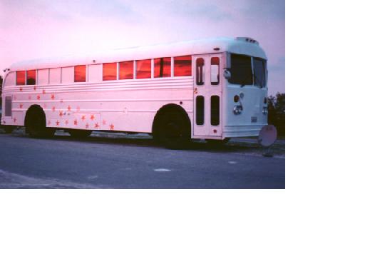

Here is a reason to do a decent paint job on any bus you may have. Can you imagine how difficult it's going to be for me to remove all the fading, chalking white paint and stenciled stars from this bus? The previous owner may have thought they were cool but, it doesn't fit my tastes. A bus should last many years, I only want to paint it once, other than touching up areas that get screwed up over its life. By the way, anyone know where I can some vinyl graphics for peace signs and pot leaves for the bus? Gillig-Dan '70 Gillig 636 Cat 3208NA pusher VIN E0013 In West Point, VA |
Rating: N/A Votes: 0 (Vote!) | Posted on Thursday, December 09, 2004 - 10:40 am: | |
yep...the hardest part...will be getting ALL that stuff off....get a big 5 to 7 h.p. compressor & a D.A. (dual action) sander & some 180 grit stick ons...was it sanded good "before" that white paint was put on????...or are you haveing 'flakeing' problems...The PREPARATION is the most importat thing in a paint job...get the surface ready..NO flakeing...all that 'erased'...nothing really wrong with pure enamel,...'cept it will over spray on anything within 100 foot & it takes longer to dry...you will need to find a barn or some big building to paint it in..was not "insulting" you saying pure enamel...the Eagle has it on her |
