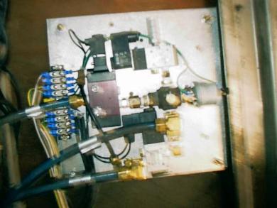

I have designed / assembled / tested a number of (Air over auto levelers) systems. I have been acquiring high quality new and used soleniod valves for the last year. I will start putting resonably prices packages together in the next month.
(A) FBSS - front/back/side/side with auto override
soleniod assemblies (no check valves required) -
(3 or 4 point systems)
(B) leveling switch consoles (up/down/auto/manual)
(c) Plus unique digital 3 or 4 corner (Plus main tank) pressure displays with low and high alarms
The system I designed and installed on my RTS conversion can raise or lower any corner almost
12"

Pete: Does your system employ the stock air springs for leveling? If so, how do you get 12" of lift out of a 12" air spring with a normal lift range of approx. 5".

Pete RTS/Daytona
Posted on Monday, December 27, 2004 - 7:08 pm:
James Maxwell (Jmaxwell) asked -->"....Pete: Does your system employ the stock air springs for leveling? If so, how do you get 12" of lift out of a 12" air spring with a normal lift range of approx. 5"."
I have stock RTS springs for my '89 - (I believe the air bag lift is somewhat greater than 5" - but I'm not sure) It's all a simple matter of Geometry - consider the air spring mounts the fulcrum of a lever - the corners are a considerable distance from the point of movement (the air springs) and the travel measured at the "corners" is close to 12"
because the movement is amplified by this condition - actually twice - because the diagonally opposite corner moved in the opposite direction will amplify the movement also.
P.S. I only use 3 points (indiviguals rears (left/right) and the fronts are tied together
RTS TMC style (3 points / 2 bags each point) - I use this system to avoid twisting the frame - I hopefully put no more strain on the frame then the engineers designed it to withstand
